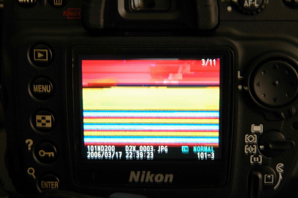

Hi all,
I have finally found out what's causing the display probem - it's not the battery, not the Sigma lens, (can't exclude the CF card yet) I think my D200 has a serious display problem.
I have been able to reproduce this problem twice by the following procedure:
1. Let the camera rest for at least over night - this problem only happens when first time turn on the power after a long period of non-use.
2. Turn on the power. Press on the display button. I have attached a image (taken by another camera) to show you how the screw up images look like on D200's LCD screen.
3. Scroll down the images on CF, all of them are displyed screw up - but, after scrolling all of them once, the images starts to display ok again.
Very weird! I suggest everyone of you owns a D200 should try this procedure to make sure your D200 display is ok.

Seems like a card reading problem. Have you tried a new card yet?

Berny,
I have tried a SanDisk CF and the problem hasn't shown up so far. It's quite likely a card reading problem. I will give it a few more days just to be sure.

It has been 3 days after I started using a new SanDisk ExtremeIII CF card, and I no longer experience the display problem!
Obviously, the problem was caused by the faulty CF card. Too bad, there isn't any utility to check for it.
Now I strongly recommend everyone to stick with Nikon approved CF cards.
