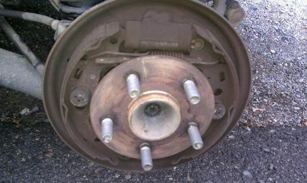

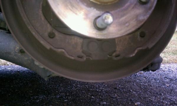

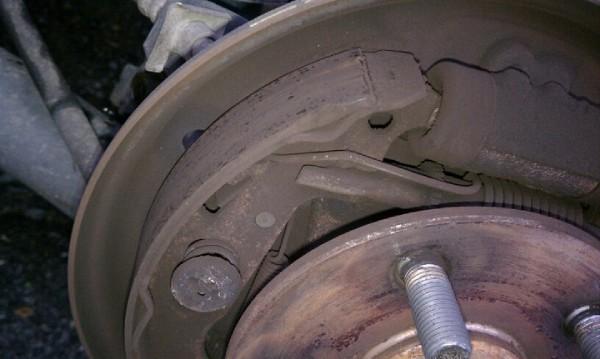

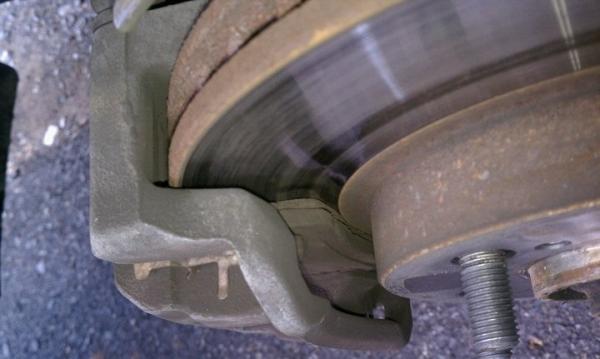

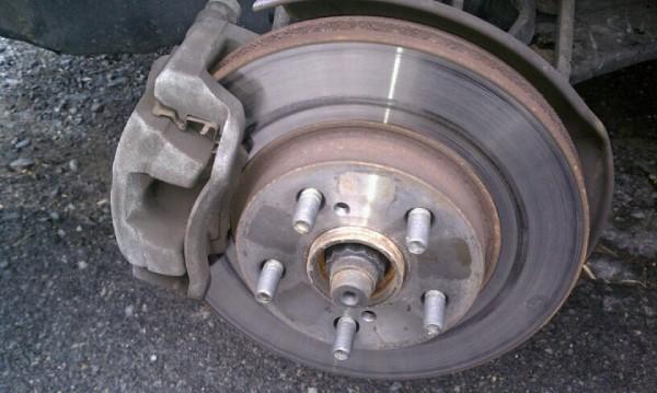

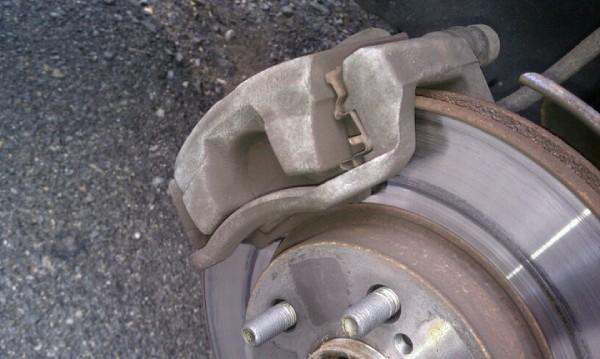

Gold Member Username: SkdooleyRoanoke, VA Usa Post Number: 1246 Registered: Oct-09 | Ok so I pulled off the back drums and looked at my front brakes that were making a noise. How do you guys think the rear pads look? I think they look a little low on pad. I went by Advance and talked to a guy there and showed him these same pictures. He didn't think the pads were real low, he said new shoes don't have much pad to them anyways. He said if I don't have much pedal (a weak pedal) its because the rear drums need to be adjusted. He said I could keep the same adjuster, just make sure its cleaned up and moving freely. For new hardware, new drum shoes, new rotors up front and new pads up front, it'll be around $145. He said the rubbing up front on the rotor could be from dirt build up under the pad. He said I should be able to keep the outside shell drum part. ![]() ![]() ![]() |

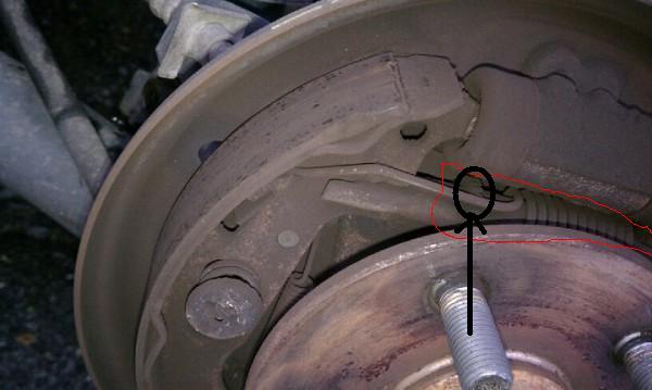

Platinum Member Username: PlymouthCanada Post Number: 15091 Registered: Jan-08 | SDK The rear brake are very good, do not spend money on it, now adjust the thing in red on the picture, it will be OK, put oil on this to be sure that it work properly. How work the automatic adjustment: with the hand break then you goes from drive to back severals times but you have to adjust before until you are able to turn the wheel with your hands Now for the front break you can replace the shoes for Carbon metalic, the problem of this car is the too small rotor for the car, put sillicone glue on back of each brake shoes to reduce the noise. you must put anti-grip grease on the slot of galipers. |
Bronze Member Username: ToothpicPost Number: 55 Registered: Oct-10 | Your front pads look good to me. Just adjust rear shoes till drum goes on a little snug. If u have to take some sandpaper or a grider to the rusty edge of the drum so you can get back on after you adjust rear shoes |
Gold Member Username: SkdooleyRoanoke, VA Usa Post Number: 1247 Registered: Oct-09 | How do I tighten them up? I know I use the adjuster but I'm not sure exactly how it "adjusts". From what I see there is a sprocket on the adjuster, I'm guessing I turn that and it will tighten or loosen my brakes. |
Gold Member Username: SkdooleyRoanoke, VA Usa Post Number: 1248 Registered: Oct-09 | Alrighty so I figured out a couple of things. The adjuster was apparently completely loose. I wasn't sure which way to turn it and so I turned it the only way it would move, which was the correct way. After refitting the drum and adjusting I got both sides tight. When I first jacked the car up, I pulled the e-brake and could turn the back wheels easily by hand. Now the e-brake is nice and tight and the braking of the car feels better. I wouldn't say 100% better, but definetely more normal. Now, I pulled off the front driver side wheel where the squeek was coming from. Apparently the D-bag who changed my pads used the cheapest set on the planet.The back of the pad itself had come un-adhesized to the pad and so when the brake was releasing, the back of the pad was but the pad itself was loose and not attached to anything. I'm going to get new rotors and pads this weekend and change them out. In the meantime I've got the pad clamped to its backing with gorilla glue and letting it dry at the moment. |
Bronze Member Username: ToothpicPost Number: 57 Registered: Oct-10 | LOL that might work. You should be good to go now anyways at least till spring. Worst case scenario you buy a new set of front pads. If you do use a c clamp to squeeze the calipers back in so they will fit over the rotors. good luck |
Gold Member Username: SkdooleyRoanoke, VA Usa Post Number: 1249 Registered: Oct-09 | The pad didn't stay glued,I'll have to deal with the squeek until Saturday. Its looks as though the outside pad, the one that is visible to me standing beside the car, was glued to the caliper itself, instead of being free moving. That isnt right is it? I believe thats why the backing came off the pad, was because it had been glued to the caliper. When I press the brakes, are both pads supposed to move or just the back one thats against the caliper piston? One last issue I've had for a long time as well is a squeek when I release my brakes. It doesn't effect my braking but whenever I take off and release my brake pedal there is a "sqqquuueeeekkk". What moves back and forth from the pressing of the brake pedal? I'm assuming only the piston. Both sides do it though. Have for a long time. |
Platinum Member Username: Nd4spd18Philadelphia, PA Post Number: 11468 Registered: Jul-06 | This thread reminds me, I forgot to adjust my rear brakes when doing my last maintenance... looks like i got a weekend task lol |
Bronze Member Username: ToothpicPost Number: 60 Registered: Oct-10 | The pads usually have a clip on them to hold them tight into place on the caliper. Not moving around. Brake pads usually have a scraper bar on them called squeakers to let you know the pads r low. That could b the squeek. Not sure about your car though.And yes the one against the piston pushes against the stationary one. Sometimes calipers stick cause the pads r worn and the caliper is out so far. I think when you put pads on and squeeze the calipers in with c clamp you will b good to go. |
Platinum Member Username: PlymouthCanada Post Number: 15095 Registered: Jan-08 | SDK Good job for the rear brake! You must clean and oil the 2 pins on both front galipers. |

Platinum Member Username: PlymouthCanada Post Number: 15151 Registered: Jan-08 | SKD On back plate of the rear break you must have a oval rubber cap, you put out this cap then you can adjust the shoe right there with a screwdriver by turning the thumb wheel on the picture: Toothpic is right! You must buy the filter and pan gasket for your automatic transmission. I recommend a Winn's additive in your transmission to reduce wear and keep all seals like brand new. |
