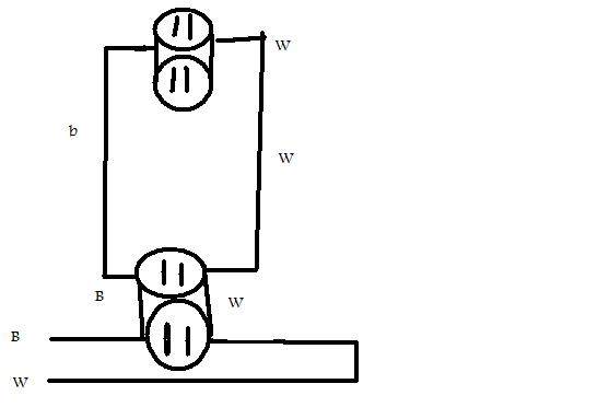

Gold Member Username: Van_manBoston South, MA Post Number: 5175 Registered: Mar-06 | I would not run the power cord inside the wall. for reasons stated earlier. Do you have an outlet beneth where you want to mount it? If so, just run a new outlet to the wall higher up from the exsisting one. Pretty easy to do. The signal cable, speaker wires, rca's can be run inside the wall np. If you want I can make up a quick sketch of it. |
Gold Member Username: Mrskullz1New York Post Number: 1376 Registered: Feb-07 | yes - i actually do have an outlet below where i want to mount it. It would be about 4-5 feet away. thanks! - i would appreciate the sketch |
Gold Member Username: Van_manBoston South, MA Post Number: 5177 Registered: Mar-06 | http://www.renovation-headquarters.com/plasma-lcd-tv-wall-mount2.htm Theres some info there, ^^^. But open the bottom plug, There is going to be black and white wires. Either a few whites and blacks in a wire nut, or a single w/b going into the plug. If the plug only has one black and one white going into it, then use the extra screw and add the wire to that, then run it to the new plug. Use an old work box, (or remodel box ). Just trace the outline on the wall, cut it, then open the wings to hold it in. Pretty straigh forward. The make a flat tv combo electrical data box that was in that link. Thats what I plan on using. ![]() |
Gold Member Username: Mrskullz1New York Post Number: 1377 Registered: Feb-07 | thanks! I'm going to decide if I want to do in wall or just use wire molding. I guess wire molding will save me lot of time and headache - i dunno. I'm going to think about how i want to run the wires lol BTW. beautiful sketch! |

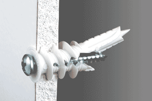

Diamond Member Username: WingmanaliveWww.stainles... .ecrater.com Post Number: 22057 Registered: Jun-06 | Toggle bolts? They require a quite large hole to get the mechanism through the wall but work well. There's also a product called EZ anchor. It's for drywall installation and I've used these many times in the past. I'm going to assume you have 1/2" drywall and these anchors have a vertical load limit of 50lbs each. Not sure what your mounting bracket looks like but if the studs don't line up where you need them to in order to center the tv then it might be an option for you. The anchors have evolved a bit from years ago and they have ones now that actually lock into the wall once the screw is driven in. Installs in seconds. Not sure how heavy your tv is but if you use only 4 anchors you're good for 200lbs. Also note that the further away from the wall the weight is the less effective these anchors are. They are designed for vertical load only. If the tv is 6" away from the wall after mounting it on the bracket then it might pivot the weight causing the anchors to fail. Just saying. |
Gold Member Username: Mrskullz1New York Post Number: 1393 Registered: Feb-07 | thanks! The toggle bolts actually lock in behind the metal stud which 'should' secure it really well. Fortunately - the mount can be mounted onto two studs - which should even the weight out. So the EZ anchor just goes into the drywall? not actually into the stud? If thats so, then i really wouldn't trust these too much. I just can't afford for the TV to fall lol. If Home Depot does have these, then I can use them along with the toggle bolts - just to be safe I guess. Gonna make the trip to HD tonight |
Diamond Member Username: WingmanaliveWww.stainles... .ecrater.com Post Number: 22059 Registered: Jun-06 | Oh for sure trust the studs over the anchors but like I said they work in a pinch. Easily removable too, not like toggle bolts. Once the butterfly is pushed through the hole that's it. Good luck. ![]() |

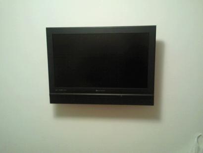

Gold Member Username: Mrskullz1New York Post Number: 1397 Registered: Feb-07 | Thanks bud! Just got it mounted. Pain in the @ss to drill the holes through metal if you don't have the right bit lol Heres a pic ![]() |
Diamond Member Username: WingmanaliveWww.stainles... .ecrater.com Post Number: 22066 Registered: Jun-06 | Nice! Have fun with it!!! |
