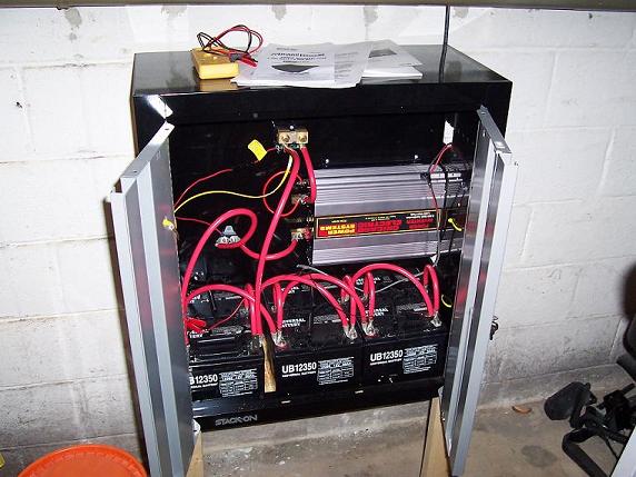

Gold Member Username: WingmanaliveA pic is worth 1000 posts!! Post Number: 6750 Registered: Jun-06 | Small 240ahr battery bank charged by small 45w panels. The cheap inverter was replaced by a Xantrex model of only 1000w. I bought a $240 xantrex meter to keep track of voltage and % of bank remaining. On a full charge I can run my big screen for hours and even a small dorm type fridge. Mostly used to recharge my cordless tools but can be used for lighting in a power outage. Serious home based setups use pure sine wave inverters and 1000's of panel watts stored in very large battery banks. It's free energy, and also somewhere we all will be looking to. ![]() |
Gold Member Username: CenusHicksville, Ohio Post Number: 3194 Registered: Jan-05 | nice paul, ya the only bad thing about solar energy is the initial cost, i mean a sanyo 200 watt hit solar panal costs $1500 thats a lot then you got to buy batterys, cables, and inverters. for small systems like yours it would work good but for big systems i don't think it would be pratical for home useage. |
