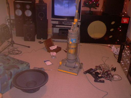

Here's a few pictures that I took early this week where I was cleaning out the sub bass enclosure. Now I know you've already seen the state of my keyboard which was really disgusting and crawling.
Cobwebs be BUGGERED, yes Spiderman has been inside the sub bass and so I sucked him out there job done!

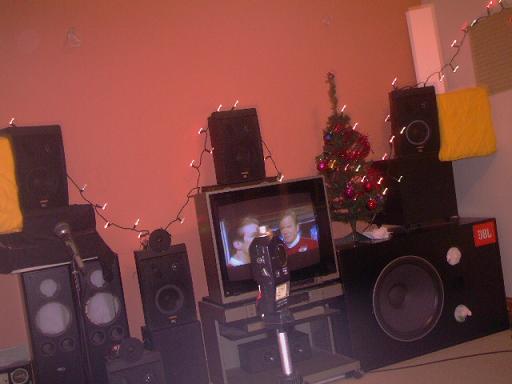

Here are a few more pictures of the home-made enclosure that was built around 8 years ago now and has served very well with outstanding results.

Is that a Dyson vacuum cleaner?
You should ask the guys at the sub section on how to build an enclosure:-)

Even the JBL 2240H needed a slight clean within the ribbon surround I used extreme care going around the whole diameter of the sub bass driver.

The enclosure was copied from the original design, thou there is a quite a few details that differ from the actual 4645 enclosure the front of the baffle is more a less the same as the original.
The port size was real guess work and thou this was a three person job from a friend who works in a primary school where he teaches electronics and is also great at building things. The wood cutting was all sized up at Columbia timbre yard the MDF 25mm all came to around £50.00 pounds I think?
The holes where all cut at my friends school in the wood shop that is the sub bass drivers hole and the three 4" port holes it was then sanded down on the edges to get sharp edge!
The extra timber for the inside of the enclosure was supported and all the screws where down from the inside!
It weighs quit a bit we never weighed the enclosure on it's own, but it took two of us just to move it!
The ports came of a demolition job that another friend was working on, the ports are simple drainage piping the depth is 6" and 4" in diameter.
The paint work was also done by my second friend. I bought all the primer and Saturn black spray paint. Some 3 cans primer was used and some 5 cans Saturn black was used it took about three days for the drying.
So I think the cost of the sub bass enclosure came in at around £75.00 UK not bad going.
The JBL 2240H driver cost me £100.00 UK from the free ads so total cost was around £175.00 UK...

so you don't know what the box is tuned to? those ports look really short.

It been up to a peak level of 120dbc, but that's down to the mix and the dynamic range of the frequency response also there is technical tolerance levels that need to be kept! Otherwise I would have said bye, bye to the JBL sub bass driver years ago.
I was reading a thread on the AVS forums where someone had blown his 18" JBL subs three times in a row!
Now that is negligence of carelessness!
In the eight years that I've had not one single problem has cursed failure of the JBL sub bass driver. There's now need to play it too hard. But the newer JBL would have a little edge over this model and with the two ports blocked off it will extend down just a bit further and the evidence shows on the RTA and the SPL db metre also the rear kitchen widow rattles to the point that it might possible crack!
Not cool if I have a broken window during the winter season!
Also adding to this it's vibrated my eyes on one type of film "Brainstorm" which has some heavy low end on the Laserdisc.
