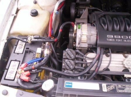

my OLD big 3 with 0ga runsUpload
u should be able to count 9 wires... :-)
2 runs of 0ga from alt+ to batt + (charging)
1 run of 0ga to chassis
1 run of 0ga to alt casing (neg)
2 runs of 0ga to back distro blk (pos) (blue + red)
1 run of 4ga to starter (factory)
1 run of 4ga to cars electronics (factory)
1 run of 4ga to engine grd (factory)

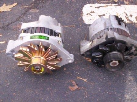

1 300a HO alternator!
I would let him leave ur factory wires in place, and just add additional big 3 wires!!
Fi AudioBTL
Post Number: 7133
yeah i got did the big 3 when i had my regualr alt in there. i knew i was gonna get the ho in a few weeks so i did it.

What kind of batt terminal supports all those wires B?

grant that was a marine battery with ring terminals, I also purchased a additional battery terminal with a extra set of ring terminals... I know its alot of wires, but the parts was under 5$
the positive has 2 poles with threads, and also does the negatives... then they have nuts to tighten on the threads...
