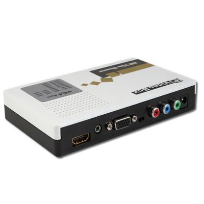

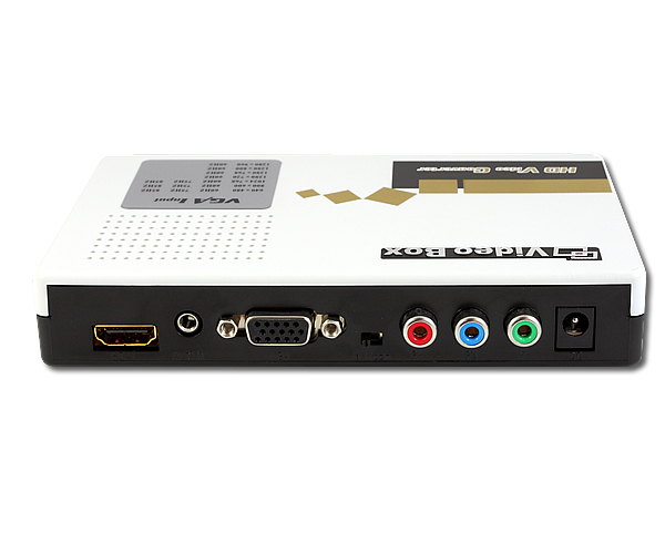

New member Username: VideofilePost Number: 1 Registered: Oct-10 | You need to get a VGA to HDMI Converter. http://www.ecrater.com/p/7324464/av-component-vga-to-hdmi-adapter Plug a VGA cable from the computer to the converter and plug an HMDI Cable from the converter to the LCD TV. ![]() |
New member Username: QiucaiwenPost Number: 1 Registered: Oct-10 | Yes, I agree with "videofile". You need a VGA to HDMI converter.Here you could find the product: http://www.aliexpress.com/store/10003/210405635-336511516/Free-shipping-VGA-to-HDMI-converter-VGA-Converter-HDMI-Convertor-High-quality.html Hope this could help you. ![]() |

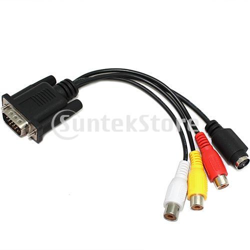

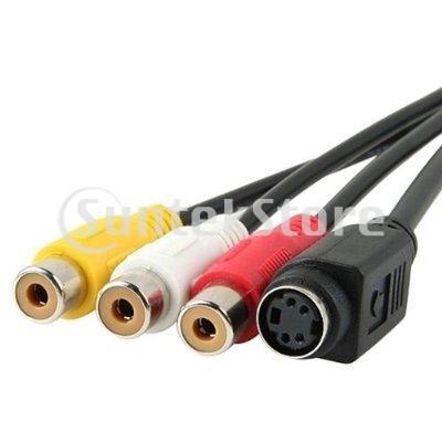

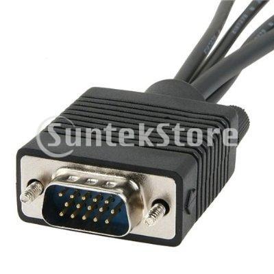

New member Username: LauraedwardPost Number: 1 Registered: Jan-12 | i think you need VGA Adapter to TV S-Video RCA Cable.This VGA Adapter to TV S-Video RCA Cable allows video output from your PC/laptop computer to any TV with S-Video or RCA video input, provided Your VGA card must support TV out directly through VGA port function.. http://www.suntekstore.com/goods-10012077-VGA+Adapter+to+TV+S-Video+RCA+Cable+-+Black.html?&utm_source=forum&utm_campaign=18 "http://www.suntekstore.com/goods-14002464-Audio+Video+AV+Module+for+Wall+Plate+Panel.html?&utm_source=forum&utm_campaign=18 " |
Silver Member Username: Ieee488Post Number: 682 Registered: Dec-07 | LauraEdward, This thread is over a year old. As for your product, it won't work. |
Platinum Member Username: Project6Post Number: 16034 Registered: Dec-03 | She doesn't care if it works or not, she just want to spam the site with her crap. |
