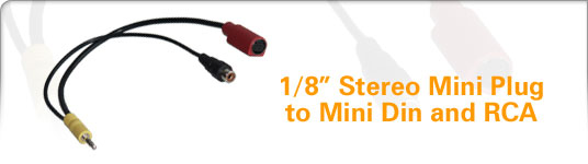

Anonymous | hi all, i noticed creative has a cable they sell to go from mini on the soundblaster to sp/dif on their speakers (i have the creative inspire 5700): http://us.creative.com/products/product.asp?category=13&subcategory=58&product=1 0375 if I buy this cable, will I be able to have my cake and eat it too? i.e. will i have 5.1 sound for movies and for doom3 etc? or is this no different than doing the mini-->rca converter option? thanks, Wes |

Anonymous | hi all! for the audigy 2 zs & z-680 users: i found this in a seperate forum, and it seems to be the right thing. http://www.dcscable.de/index.php?cPath=28_263 it propably works with other soundsystems/decoders,too. the thing is, that the 3,5" jack has to be MONO, not stereo (no, that doesn't mean you get only mono sound, it's because of the digital layout... with a stereo jack you it could eventually work if the contacts connect right, but thats not the right solution). i ordered it, but it hasn't arrived yet, so i will post if i get it to work... (the shop is a german one, but i hope you see what cable it is and that you can find one in your local one ;-)) greets, linus |
