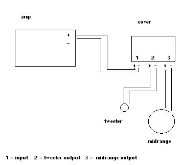

I just got my component speakers and amp today from UPS and was wondering if anyone knew where i could find some good instructions on how to install them? I'm mainly confused with the crossovers so if anyone has some or know where to find them it would be extremely appreciated.

Basically you need to run your postitve and negative into the crossover where it has a + & - that probably says something about in or input over them. For the output to the speaker and tweet there should be a + & - label speaker and tweeter. I would think it would explain itself... Mount the crossover in the door if it is possible, if not get it as close to the speaker as you can.
Hope that helps

the first positive and negative will be from your source HU or amp. Hopefully an amp since you are using components

bingo^

thanks that helps alot seems like common sense now:-)
