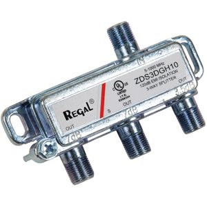

i Got one of those splitters with 2 @ -7dbs & 1 with -3... Which one of those should i hook my modem connection into?

its thatUpload

its what my isp put in "professionally" It worked fine for 5 years

My cable goes like this. From the wall, to that RF Splitter thing i posted a pic about above.. the -3db has a cable running from that to my cable modem, one of the -7db is going to my Cable tv box & the other is going to another cable tv box in a diffrent room.
