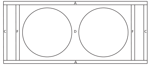

Silver Member Username: Joe1234Post Number: 855 Registered: May-09 | Ok caveman, let me know if this is your sub: http://skaraudio.com/index.php/products/vvx-12/item/vvx-12-sub-woofer.html Separate chambers are better here because it makes unnecessary to add bracing, check this center port design: ![]() Can you manage to build that?? Also on the link they recommend this for ported enclosure: 1.75 CuFt Per Driver after displacement of sub. Tuned ~36hz You want that or bigger, most designs are going for: 2.0 CuFt Per Driver after displacement of sub. Tuned ~30hz Makes a bigger enclosure sounding lower but maybe takes less power. If I go for a single slot port on one side I will have to add a center brace (if feasible), would you prefer that? |

Silver Member Username: Joe1234Post Number: 856 Registered: May-09 | That enclosure is tuned to 40Hz (too high) and is designed for the displacement of a diamond audio sub so it's no good, but I can go for individual chambers with ports on the sides. But I would stick with L shaped ports just to keep the build simple. ![]() So that would probably be my suggestion a 2 cuft per chamber tuned to 30Hz with ports on the sides like you see in the picture above. Would you like that?? its easy to build and design. |
Bronze Member Username: CavemandjdMorgan City, Louisiana United States Post Number: 69 Registered: Jul-11 | Sounds like that'll work plus it'll be easy to build. |
