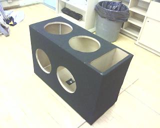

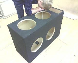

Silver Member Username: MoorezySt. Catharines, Ontario Canada Post Number: 169 Registered: Jun-06 | So i just setup my new stuff which consists of.. a hifonics 1606D, kicker 1/0 gauge wire kit, big 3, new H.O alternator from db electrical, four pioneer premiere TS-1207D2 wired to 1 ohm. And of course i had already built my enclosure.. or so i thought... i install everything... i play music... and the subs.. move... but sound seriously wack. like not loud at all.. so right away im like okay. settings on amps. i fool with gain just a little. they get a little louder.. but no air is coming from my port.. 5" wide 25" deep 14.5" high.. i eliminate electrical problems after checking ground and cables. so i narrow it down to my box. or the position of my subs from a friend at a local car audio shop. He thinks the box is too large. or port volume is too much. I disagree on the box size. but i do agree with the subwoofer position and port volume for that box. long story short i am going to have to build another box. I wanted some imput on the volume..tuning or if someone could do a design box for me that would be awesome. the dimensions i can work with are 14" tall, 27" wide and 37" wide. Here are pics of the old box. ![]() ![]() ![]() As you can see the way the subwoofers are facing we were thinking it was canceling the sound or whatever. so in this design i would probably be aiming for all four facing up port towards trunk. Any help would be great i want to get this new box made and i want to be slamming in a few days ![]() ![]() |

Gold Member Username: Nd4spd18Northwest PA Post Number: 4559 Registered: Jul-06 | Yeah you're not supposed to build a box with subs on different sides........ but I guess you didn't know that. |
Gold Member Username: FrkkevinResonant Engineering..., Fort Worth... Email Post Number: 4293 Registered: Nov-05 | don't really matter.. either way hell get cancellation even if they are all on the same plane.. use a DMM and test the final load.. i really think something is up with the wiring.. unless a sub is mislabeled.. or you have d4s and not d2s ![]() |

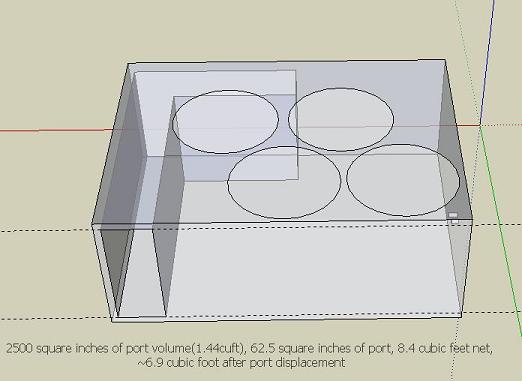

Silver Member Username: MoorezySt. Catharines, Ontario Canada Post Number: 171 Registered: Jun-06 | the wiring is correct i used a meter to test. and they are its 1 ohm load. like my port is just one straight piece. no L shape. i think it might be something to do with port length and port volume. and the cancelation. like i said. there is no air coming from port. and the subwoofers are full excursion. just doesnt sound right. im powering 350 each maybe more ^^^ i say hifonics 1606D above and i have big 3 and 200amp alt. More or less im building a new box and i need some input for designs this is what i came up with so far. ![]() That gives each sub 1.75 cubic foot each. i dont know the tuning im guessing 32-34 because i got the volume from kicker cvr12 specs of 12.5"x2.5"x20" and multiplied that volume by 4. |
Silver Member Username: MoorezySt. Catharines, Ontario Canada Post Number: 172 Registered: Jun-06 | that box is 37" long 28" deep and 14" tall btw ( the one in sketchup ) |

Gold Member Username: InsearchofbassPost Number: 7370 Registered: Jun-04 | "the subwoofers are full excursion. just doesnt sound right." your getting cancellation... its possible even without having the wires mixed up.. definately get the subs on the same plane |
