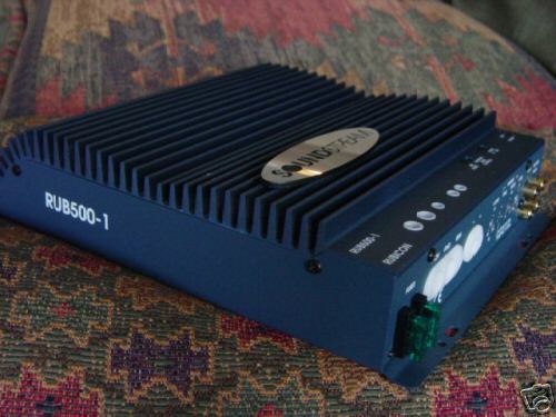

kicker kx1200.1 Dont get that amp those can handle 1000rms a piece a 1200 watt amp is not enuff
If you got the cash I would get 2 of these
http://www.onlinecarstereo.com/CarAudio/ProductDetail.aspx?ProductID=16922
Wire them like this
Get a HO Alternator
A deep cell battery or 2
19 feet or less of 0/1 Ga wire (from battery to spliter.
I would recomend a large box ported to ~32-34 hz.
