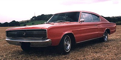

Gold Member Username: GlasswolfPost Number: 1139 Registered: 12-2003 | my Charger is only 425 horses, but 490lb-ft torque ^_^ anyway on teh highway it doesn't matter. It's in residential areas and such that it's really irresponsible. There's a difference between 70MPH, and sitting at a stoplight in town, ya know? |
jay amaro Unregistered guest | hey wolf...cool im building a tuned port 383 supercharged stroker for my camaro but i havent had time to finish it yet and yet another year went buy and its still waiting to get into the car but its also still gonna remain a daily driver and street car but my target HP is 550 to 600. i love rat engines! how about you are you using a big or small block? right no i feel under powered with a slightly modified tuned port 350 with ram air and only 320 horses but anyways one day ill have what shoulda been in there to start with. those are some good torque number, what do you use for the rear end? mopars use dana's dont they? i got a hoghead ford 9" lined up for the stroker but dont need it yet since i have no real power yet. yeah i agree with you though and a system owner should have better sense in managing their system and i think its basically common sense as to when adn where to turn it up and when not to. more times than not i like to turn my system down just to hear the engine, and its a great sound from the exhaust and engine when your twisted up over 6000, how about you wolf? im sure you know what i mean. heh but then again i guess if i had an import id keep my system turned up as loud as it will go since they can never make their engines sing like a good v-8. jay |
Gold Member Username: GlasswolfPost Number: 1151 Registered: 12-2003 | 1966 Dodge Charger with it's original numbers matching 426 Hemi big block V8, and 4-sp transmission. 250 were made in 1966, of which, 53 are known to still exist. factory stats are: 425HP @ 5000rpm 490lb-ft torque @ 4000rpm |
jay amaro Unregistered guest | heh heh aha a '66 426 hemi...well thats an extremely under rated engine if i ever saw one. very nice! i've heard the hemi's put out number closer to well over 600hp just like the fords cobrajet engines and at that crazy time in the 60's alot of those great big blocks were under rated to get them into nascar but in any event nice charger. i have a couple friends here who builds and collects mopars...hes gonna love seeing that pic of yours! i have nothing that rare yet but right now i have my eye on a all original 69 chevelle with a 350 turbofire thats only got 67,000 original miles and factory air, its from a old couple who bought it new and was a farm car and if i hadnt have seen it a couple weeks ago i wouldnt want to buy it but its stuff like that that keeps me from finishing my engine :P ive got the 87 iroc z-28 66 mustang 289 hi po w/fact air 65 galaxie 500 2 dr hrd tp with a 390 w/dealer air 71 mustang fastback (not a mach) no air 89 oldmobile cutlass ciera intl. and i need the late 60's early 70's chevelle, a late 60's camaro or firebird, a late 70's trans am preferably the smokey and the bandit edition and a 69 or 70 mustang mach 1 and a 71-73 mach, and a satellite, road runner or barracuda from the early 70's to finish all the cars i have to get before i turn 40. its so good to see any of the old cars being saved and taken care of. jay |
