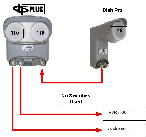

Hello,
I have dish pro plus pointing to 110,119. i have 2nd dish with single lnb pointed to 148.(connected to input in dpp lnb).Everything was working fine until i got rid off dn reciever now my pvr7000 can not get signal on its own. I have read many forums that dpp needs more power than fta can provide.
I have 2 questions:
1) can i use some power inserts or switch to make pvr7000 work on its own with dpp lnb?
2)what switch can i use to convert 2 connection i currently have into 4 connections if i want to expand and add more recievers.
my setup looks like the attachement
Thanks very much in advance.

it needs to look like this with a DN receiver (can be unsubscribed) to power the LNB's..this is for only 1 FTA receiver..
BTW...Legacy 4700 is a Dishnet receiver, and U can use any FTA instead of the PS 3500 in pic..

"was working fine until i got rid off dn reciever"
AT the VS extreme end you can piggyback a DN receiver for power only with a splitter.
