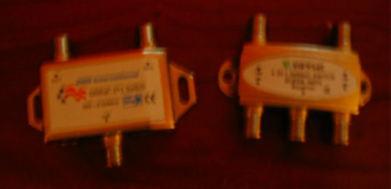

Username: Crazy_greek
Post Number: 689
Hey chinny
If I understand you right the is Yes.
What PR was telling you was not to mix the Voltage.On 119 If you use left side of the LNB,
that use left side of 110 LNB.
You can use either switch. Don't use splitters.
Use DiSEqC Switches.
Username: Chinny
Post Number: 19
Registered: Jan-07
its not a splitter, its a DMS International 2 in 1 DiSEqC Switch. it looks like a splitter but it says "DiSEqC 2*1 Switch" 950-2150MHz. DiSEqC2.0.
Im using both left sides on the lnb. SAT1 on the switch is 119 and SAT2 is connected to 110.
Everything looks good to this point.
