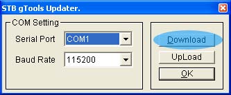

i tried flashing my pansat 2500a but it always gives me an error message some people say its the cable but i took the cable back and the guy at the store said that it wasn't the cable he said that it was my com1 that it wasn't activated thru some bois thing but i don't know what to do.

Starter this what you need:Upload
