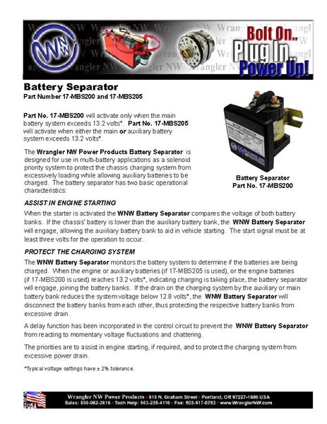

Also note that with a dual battery set-up you should always replace both batteries at the same time. So replace the existing battery if you add another one.
This is what I use at my shop. It works better becaue you dont get any voltage drop like in a isolator.
