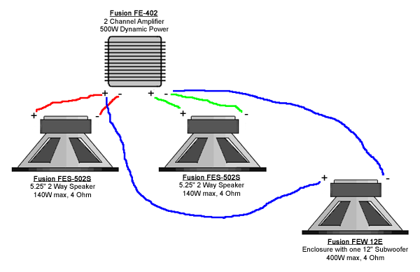

Hi, maybe there is a simple answer to this, maybe not... Anyways, what's the proper/best way for wiring two 5" speakers and one subwoofer to a 2 channel amplifier? Pic is attached. Is this the right method?
there's not a good/best way to wire 2 spkrs and a sub on a 2 ch amp, it's called tri-mode, and it's a marketing gimmick more than anything.

Actually, those posts from justin aren't related to my post at all. I think he acidentally posted here. Thanks for the tip on the "tri-mode" label. I do see that there are some tri-mode crossovers out there, although they do seem rare.
