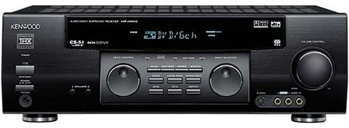

Over the last few months I have expanded my stereo system to get 5.1, and it is a great pleasure. Watching movies is better for the whole family, and more of a shared experience, an unexpected benefit. The final link in place was a sub. I don't think the brand matters here.
DTS is really great. I connect the sub to the line-level 0.1 receiver output. With the sub "level" control set at 12 o'clock, the sub sounds exactly like a natural and balanced long downward extension of the whole system, in the whole room. Low frequency extension shakes and surprises you. It is part of the experience.
Dolby Digital, with same DVD, set-up and settings everywhere, is really bad. A lot of detail is missing from all 5 channels, especially the surrounds. But the big issue is the sub. Dolby Digital gives continuous high levels of pointless bass. It is tiring, and removes the drama from explosions and all that, because you have been blasted with bass all the way through, anyway. Anything with a bass guitar is a complete pain, like "megabass" stuff on a cheap Walkman.
Is it the sub? No, it is the same sub. Same connection. Same settings.
Is it the receiver? Well, I can turn down the LFE channel 6 dB and Dolby Digital is still far too loud out of the sub. And the peaks still come as no surprise. For example there is a great thunderstorm in The Bourne Identity (good movie). It is startling in DTS, just more noise in Dolby Digital.
Is it the processor in the receiver? If I turn off the sub and direct the LFE channel to the main speakers the problem is not there, or not as much. Maybe the processor in the receiver has got it all wrong? But it is an OK make, and has the Dolby double-D badge.
Is it the source? All DVDs with DD and DTS give pretty much the same result, so this seems unlikely. And not all recording engineers are addicted to banging their heads against walls. If they were, why would they do it only in DD? Has Dolby advised recorders to put 10 dB extra sound pressure level in LFE for some reason? I have one 5.0 DVD-audio disk. DTS does what it says on the tin. DD gives a 0.1 output anyway. And it is far too loud. Does this mean the processor is at fault?

Now I find the bass-heavy DD effect goes away when the sub is connected to the speaker output. But DTS still scores higher for sound quality in every way. I wonder if DD is doubling the bass to the dedicated ".1" LFE channel by giving it the low frequencies from the main channels, too, in order to try to compensate for small main speakers? Or just to blow the socks off customers in brief showroom demos?
Back to using the "Sub out" line output, I get the impression DTS mixing assumes a decent audio system; with DD the effect is like "mega-bass" on a Walkman. Argh. Mega-bass effects confuse bass volume with bass extension. Is this DD's problem? If you have a sub at all, you don't need to color the sound like that. The effect is not in-yer-face, its banging-yer-head. Against a hard wall.

In order to correctly reproduce DTS signal on movie soundtracks, your DTS decoder must be capable of adding ten decibels to the LFE channel.
On my DTS decoder, the default setting for the LFE channel in DTS mode is +0 db. The manual tells me that for watching DVD movies encoded with DTS, I should set this to +10 db. In DD mode, the correct setting is 0 db. So, I have my decoder set to reproduce the LFE at 0 db for DD and +10 db for DTS, which are the correct settings for movies (for DTS audio CDs, apparently, you should set the LFE to +0 db).
I find that with this setting, I can calibrate my system for both DTS and DD and the LFE level is correct on both.
It's possible that your DTS decoder does not include this setting, which will make it harder for you (LFE will sound softer on DTS than on DD). However, I assume your decoder will have it.
This means it's not that the LFE on your DD sources is too high, it's that the LFE on your DTS sources is not high enough. You need to set the DTS receiver to output LFE at +10 db for DTS. Then, you can adjust the gain on your sub for this level and it should be find for both DD and DTS.

WHen I change it from Optical to Coaxel, the face of the receiver changes to DTS, but the DVD is still selected on Digital.
Confusing, very confusing.

Username: Hwjchim
Post Number: 11
Registered: Dec-03
True. If I do not select anything, it will give me Dolby Digital by default like you said. That is true.
When I change it over from Dolby Digital to DTS, I hear no sounds. I see DTS on my player, but I hear nothing.
In my manual, it has a chart listing all sorts of modes down the left and 6 source formats across the top.
Analog/PCM, 96kHz PCM, Dobly Digital (2 channel), Dolby DIgital (Others), DTS (5.1), DTS (6.1)
I see checkmarks under dts 5.1 & dts 6.1 for the following modes:
Stereo & DTS
Hm, still lost like me?
Username: Hwjchim
Post Number: 12
Registered: Dec-03
Ok. I did something here.
I got 2 dvd players hooked up to my receiver.
1 is connected via dvd and another is connected via Video 1.
DVD Player 1 ...Can not hear DTS. It is supposed to play DTS though. I have it set up as:
Optical audio output & SVideo output.
DVD Player 2...CAN hear DTS. It is set up as:
Svideo output & Coax Output.
I rearranged the inputs for DVD Player 1 to follow DVD Player 2 but no DTS still.
The only difference is that DVD player 1 has Optical and no COAX while DVD Player 2 has COAX and NO Optical.
Can that be the factor which decides if I am to get DTS or not?
Thanks
Username: John_a
Post Number: 572
Registered: Dec-03
scott,
Well, you have progress! You get DTS!
Optical and digital co-ax interconnects are two ways of doing exactly the same thing. They both transmit data for DTS, and any other digital data (CD, Dolby).
You can swap things around. WIth a bit of experiment I think you'll find out what the problem is.
Consider the possibility that both players can "Hear" DTS on the DVD disc, but DVD Player 1 is unable to pass the message on to the receiver and so you don't hear it from the speakers. By the way, what it sends is just data, and it is the receiver that works out it is in the DTS "Language", then translates it.
From here on, I would first take a good, close look at that optical cable. If it transmits data in Dolby Digital "Language" (quite sure? real 5.1?), it must be doing OK. Whatever sort of data is going through, you can usually actually see the laser light coming out of the port in the player (don't look directly into the beam). Then, if you plug in the optical cable, you can see if the light is coming out the other end of the cable.
Let us know when you get it sorted out. I think you are nearly there.
Username: Hwjchim
Post Number: 13
Registered: Dec-03
Well, I did what you said.
I played the dvd on DTS audio (DTS 3/2.1)
I still hear nothing.
I played it on Digital (3/2.1) I hear.
I took a look at the optical wire.
When it was on DTS, I see no red beams.
When it was on Digital, I saw red beams.
On the back of DVD player 1,
these are the outputs listed:
Optical output
Component Video output
Audiot Ouput Left, Right & Subwoofer
SVideo Output
There is no Multi-Channel connection.
Do I need this to get DTS?
So weird. DVD Player 2 has the same outputs and DTS works, just that i'm using coaxial instead of Optical.
http://www.timefordvd.com/hardware/review/Panasonic_DVD-RV31.shtml
That is the dvd player I have. It does say DTS is playable.
Hm...
Username: Hwjchim
Post Number: 14
Registered: Dec-03
John, Thanks a lot for your help.
I finally got DTS to work.
I did a little searching on google and came across another forum stating:
First time Using DTS on my system and there is no sound when selecting DTS on a DVD. Dolby Digital and music are working though, why?
All three of these things MUST be present and configured for DTS playback:
1) Your receiver must be set to "Auto detect" or forced to DTS decoding.
2) In your DVD player's digital audio setup menu, you must ENABLE DTS. Dolby digital is on by default, and on 99.9% of players, DTS is NOT turned on from the factory.
3) Select the DTS track in the disc's setup menu.
After I turned DTS on, it now works perfect!
Thanks for all your help, I really appreciate it!
Woohoo!

Many thanks. I wonder if you would mind identifying your receiver?
50 Hz on the main speakers is borderline. The effect I heard was with speakers at 40 Hz - 3dB cutoff.
The other cure for my Dolby megbass effect was to connect the sub at speaker level, not line level. If I go back to using a sub, this is what I shall do. My current speakers go to 35 Hz and I really think a sub is low priority in this case. Even 50 Hz could be regarded as full-range. 85 Hz (as many home cinema speakers) and a sub is much more likely to improve things.

It's a Kenwood KRF-X9050D THX select model, yes she is around 5 years old and still able to give the best sound at an affordable cost...
