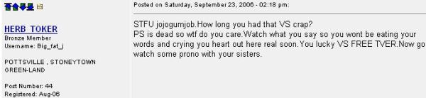

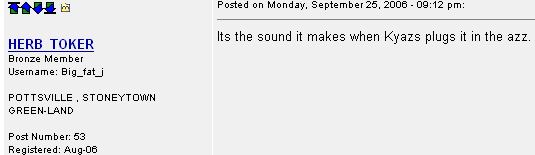

HOW DARE I MAKE SUGGESTIONS OF G*YNESS!!!
The history of a hypocrite:
Again, u don't get 2 tell others what the rules are when ur blatantly breaking them urself.
