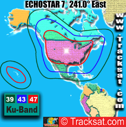

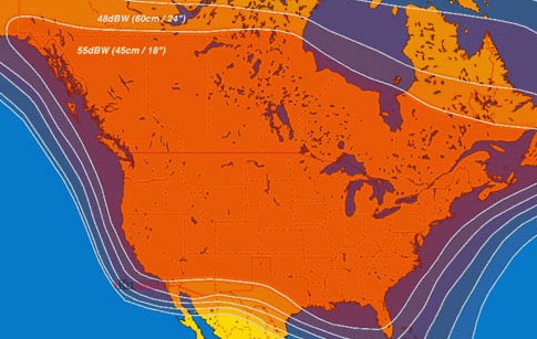

Username: Boyce
Post Number: 155
Registered: Apr-06
You need 30" dish, see 119 foot print even red deer is not easy to get 119 on 24" dish.
see Upload
Username: The_wank_artist
Post Number: 645
Edmonton, Albert, Canada.
Antenna Pointing
119 Echo7;
186.927539: Azimuth (Geographic)
28.629975: Elevation (Degrees)
110 Echo8/6;
175.749539; Azimuth (Geographic)
28.764806: Eleveation (Degrees)
And LK is correct, again. No need for a bigger dish....
