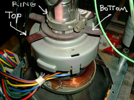

New member Username: JayzPhiladelphia, PA USA Post Number: 9 Registered: May-05 | I need help -------------------------------------------------------------------------------- Convergence Problem -------------------------------------------------------------------------------- Can anyone tell me what adjustment on the CRT, is for the Horizontal control. I'm having a problem with the Blue CRT, Getting it on the same plane line as the Red and Green. When trying to adjust the three CTR's , the Blue gun projects off center of the plane line . High on the left side, okay in the middle and low on the right side, which is throwing everything out of kilter.I changed the coolant recently in all three CRT's and quality of picture is really sharp and clear. I now need to know how to fix this problem. Does anyone out there have any answers? 1996 Magnavox 55" Rear Projection #6P5440W103 Any help at all would be great Jayz ![]() |

Bronze Member Username: JayzPhiladelphia, PA USA Post Number: 13 Registered: May-05 | Hi Casey, Thanks for your input. I have tried doing it by the cross on convergence. But I can only go so far with that. About a month ago I just changed all the coolant in the three CRT's. After I put them back in the set, the only one really off is the Blue gun. It seems to be off the plane line. Would you know if the locked focus ring >look at photo < might be the answer to getting it back on the right plane, the other two adjustments in the photo{ Top and Bottom } control left and right, and up and down, but not the plane line. Any input or help in this matter, would be great. George ![]() |
