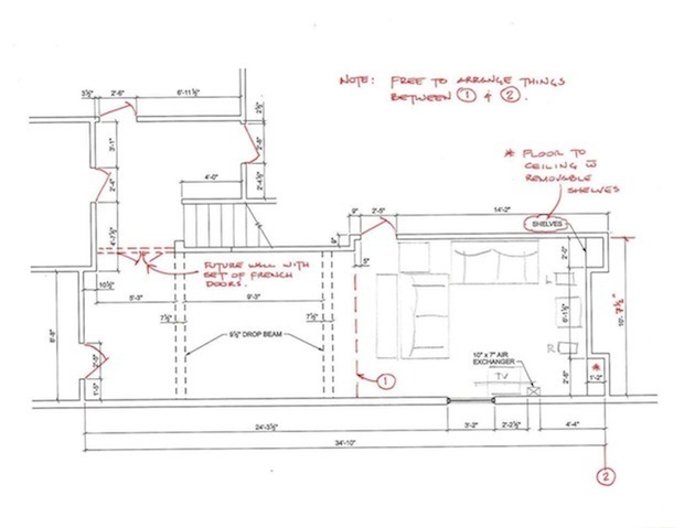

I am considering a pair of Anthony Gallo 3.5's.
My front end consists of a Simaudio i7, Simaudio Supernova CD player, Wadia 170i dock and a Bryston BDA1 DAC. I browsed through the posts to see if I could find and reference of using Simaudio with the AG 3.5's, but I didn't so my apologies if I missed it. Does anyone have any experience using the Ref 3.5's speakers with Simaudio gear?
My room is approximately 11' x 33' x 8' ceilings. My system faces the long direction and I sit roughly 10 to 12 ft from the front wall. I like base, but I prefer not to overwhelm the room with an overly obtrusive speaker as well to obtain base.
I listen to a mixture of rock, pop, folk, new age. Rarely any country or classical.
What are your thoughts on using the 3.5's based on my gear/room and musical tastes?

The combination of Simaudio and Gallos doesn't particularly bother me. However, the width of your room bothers me when you are thinking about placing such a wide dispersion tweeter in a position so close to a highly reflective surface. With only 11' to work with - is that the correct measurement? - you would most definitely need to think about some room treatments to tame the reflection zones. That would apply to any high end speaker design with a broad dispersion tweeter.
An alternative which would mitigate a few room issues here would be a single driver, full range system which by its very nature has a more directional pattern of disperion. Or you might consider a bipole design such as a Magneplanar with a bipole high frequency driver. The bipole isn't my first choice since a bipole has less radiation to its sides than does a monopole like the Gallos but, at the least, the bipole's figure of eight radiation pattern will have far fewer very early and very strong first reflections off the immediate side wall. By limiting the side wall reflections using the natural patterns of the speaker itself rather than loading in large amounts of broadband absorption panels, you should find the sound to be much smoother with far fewer comb-filter and phase effects arriving at your listening position.
But I would strongly advice you to avoid broad dispersion tweeters in the room you describe above.

Thanks for your comments and this was one of my concerns. I should have noted that we are building a new home, so the future home of my system will be custom designed. In the meantime, I plan on acoustically treating the room I described. Alternatively, I was curious about locating my system to face the short direction. I do have some flexibility, but not much. If I do this, the left speaker would be roughly 6 ft +/- from the left wall and the right speaker would be about 20 ft +/-. My concern in placing them along this wall is that they will need to sit closer to the front wall due to the limited 11' width. Thoughts?
My other options for speakers were PMC 23's or 24's, Salk Supercharged Songbirds or HT2-TL's, or Legacy Classic HD's or Signature SE's which I feel are too large.

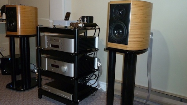

So, what's the problem integrating the LaFleurs with a sub? I would guess the problem is more getting the sub to integrate with the room. Did you try a specific set up procedure for the sub?
I don't know. Both subs I have have the room EQ setups which I utilized. I also tried placing the subs at various locations. As indicated earlier, I tried just about everything including trying a different room. I don't know what else to say. Just figured it was time to try new "full range" speakers based on my results with the Paradigms.}

integrating a sub can be difficult. It takes time to find the right positioning, sometimes room treatements, and tuning or dialing in the settings for the sub (phase, XO, etc) so yeah if it isn't set just right it can sound lousy very easily, but I think Jan has it there, that the integration problem was with the setup and not just that they don't work with a sub, period.
A couple of problems I saw with the photo above are that there is no apparent sound treatment done to the room, including the wall behind the monitors for second order reflection, and the speakers are just too close together for good imaging. Do a google image search on speaker positioning and you'll see a lot of diagrams on speaker location and angle in relation to the sweet spot or seating position. They are a good starting poiint for finding the ideal spot for the speakers. Distance apart, distance from the wall and corners, and height all make a big difference in their performance in a given room.
By the way, those are some gorgeous looking monitors there. The shape reminds me a lot of my KEF Q1 monitors.

Without knowing your speakers or hearing your system set up I can only guess at what might have caused the integration problems. My first guess would be the room. My second, third, fourth and fifth guesses would be the room.
On the one thread I linked to you'll find another link which should take you to the ASC website and their page on room modes and null points. It will also discuss the position of your listening chair's influence on sound quality. Setting up a speaker system is more than just putting the speakers "X" distance from a wall. It would be worth your time to do some studying there. A room with such a long dimension in one direction and such a short dimension in another coupled with a very low ceiling height is destined for enormous peaks and valleys with obvious standing waves and slap echoes. The room surfaces are very unlikely to contain bass waves which will make for even more problems. Problems of this magnitude are not going to covered up by automatic room eq. I would guess that in another room of more audio friendly dimensions and construction the pairing would have worked out.
I have to surmise that without any real plan to set up the speakers and sub your chances of success are rather slim. You must attend to the basics of system set up before you begin throwing money at equipment. There is no doubt the room your system is in right now will require somewhat severe room treatments. In fact, any domestic room - even those built from the ground up and with the assistance of an acoustician or someone well trained in the science of sound - will require some degree of absorptive treatments to even out the response of the average domestic audio system. You might as well begin now with your present room and whatever you buy will easily transfer to a new space.

I just saw what is most likely a large portion of your problem integrating a sub with your current speakers, the extremely low sensitivity of the speakers; http://www.soundstagenetwork.com/measurements/speakers/lafleuraudio_x1/
At 81dB your current speakers are among the very lowest sensitivity systems in audio. They are not a difficult load for most amps but most subs you will find on the market will not mate with a speaker that is that low in output per watt. This is a similar problem those of us using LS3/5a mini-monitors faced when we wanted deeper than 50Hz bass extension. The 82dB 3/5a's did not play well with subs meant for the "average" speaker. Add to the sensitivity issues the very "fast" and tuneful sounding woofer of the monitors and subs simply sounded as if they were from another planet. There was a model specific sub eventually built for the 3/5a's.
Possibly I'm wrong about your speakers and the subs you tried but I would certainly think you would have difficulty finding a sub that was the match for $14k, 81dB speakers.
This doesn't mean your room is not in need of attention but from experience I can tell you extremely low sensivity speakers will require an almost model specific subwoofer as an effective mate.
From the on paper measurements of the speakers though, I'd say you'd be taking a step backward in sound quality even going to the Gallos.

1. Is it possible to move the subwoofer out of the corner? That corner will re-enforce the bass BIG TIME!
2. I can't tell by the picture, but how is the sub connected? Is it at the speaker level or using a sub/LFE output via rca/coax cable? If it's the latter, there should be a subwoofer level control in your preamp that you could trim a little.

So, now that the speakers will be a reality within a week or two, I guess what I will need assistance with is properly setting up and treating the room.
The suggestion by Superjazz of building an "outhouse" for my music room is not in the cards. I think that is called "divorce", and I like to think what we are doing is making sacrifices to accommodate each other. Perhaps I'm sacrificing more from our opinions, but she might not agree.
Anyway, would it be best to wait until the speakers actually arrive or is there anything that can be done before they arrive? Perhaps I can sketch out the room with furniture locations and all and post on here for a more detailed look at what I'm dealing with as done by others?
Username: Magfan
Post Number: 2834
Blue: NOW do you see why I used the word 'treacherous'?
I had my original panels in maybe 8 or 10 different rooms in the 20+ years I owned them. I got very acquainted with how to set them up and eventually got quite good at getting an optimum setup in any room in which I had my stereo. And, since the panels were clearly marked 'left' and 'right', I even broke that 'rule' a few times....and it helped. I'm talking about a room 10x11x8 all the way up to a gigantic 2 story living room, with balcony and a dining room sep'd from the LR by 2 arched doorways. I put the speakers in front of the doors since I had 100% freedom to do whatever. The backwave took so long getting out of that space and it was so well mixed that it just added ambience. An amazing space.
My suggestion would be to begin reading up on room setup and treatment. Find out what 'first reflection' points are. Begin checking with the spouse on what would be acceptable limits for room modifications and setup. Negotiate. I know the problem with compromise is that it's compromise, but I'm guessing you'd like to stay married and not end up living in your car!
By all means sketch the room. Google Sketchup is a freebie and good for all it does right. I pre-build all my wood projects in sketchup before even buying a slice of lumber.
As for an additional 'outhouse'. No need to go to that extent, though a properly designed room addition works wonders. Building costs these days for a regular room are about 150$ per sq/ft so figure upwards from that.

I was preparing a sketch to go to some acoustical companies so I thought I might as well show it on here as well.
The sketch shows the portion of the downstairs where my stereo system is located. I have shown a couple of loveseats (rough guess at dimensions), sofa back table, end table and TV and console which currently reside in the room. The stereo component rack and speakers are at the far end of the room where the shelves are shown. The window that is shown in the room is near the ceiling and is only 13" high (from the ceiling level down). The ceilings are 8' with the exception where the two drop beams are shown. The ceilings are a textured plaster on drywall. The floors are carpet over concrete which will be changed to some form of floating floor. I will likely remove one of the sofas and replace it with a chair to make a bit more room. I want to keep any changes to within the lines marked by 1 and 2.
I do not use the stereo when listening to the TV.
The components you see in the pic are the same except the little headphone tube amp has been replace with a WooAudio WA6 headphone amp, but it sits in the same location. As you know, the speakers will be the AG as opposed to what is shown.
The shelving at the end of the room is floor to ceiling and consist of removable shelving. I haven't approached the topic with my better half, but I will go out on a limb and say they are free to be used in some way for acoustical treatment.

Username: Bluemark81
NB Canada
Post Number: 129
Registered: Apr-06
Here we go....damn mac!

Ok, further suggestions would include removing the sofa on the left side of the room when you are facing the system end. Also, relocate the TV. You are very likely going to need the remaining sofa and tables pushed back further into the room. The door to the left of the centrally located sofa, where does it head? What's on the other side of the door and how is that wall constructed? 2"X4" and drywall? Or, something more substantial? I assume the other wall is similar construction, yes?
NB Canada
Post Number: 130
Registered: Apr-06
I am planning on removing the sofa along the wall. The door you mention is not used. It enters the same space as the door to the immediate right of the stairs. The wall is of 2x4 wood stud and drywall construction. The wall on the opposite side of the room is an exterior wall of drywall, 2 x 4, insulation, and concrete foundation.

You mention relocating the TV. What do you suggest? We want to leave it within the same space as the audio gear if at all possible. I initially wanted to divide the room in two by putting a wall where the first drop beam is (nearest the red line labelled "1"), but that is not happening. Rather, we are installing a new wall with french doors where shown at the foot of the stairs.

The TV's position needs to be as far away and as isolated from the audio system as possible. If it can't be isolated, then you'll need to cover the TV with a blanket when you use the audio system and, for balanced sound, you'll need to provide another absorptive surface on the opposite side of the room from the TV.
