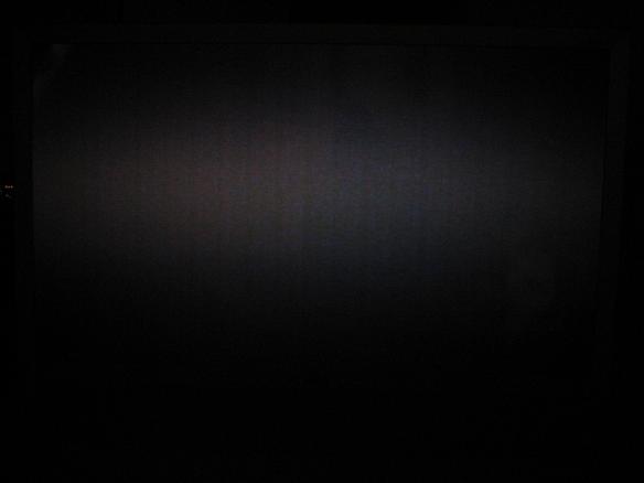

I bought a Samsung HC4241W earlier this year but I've had problems with it. The TV produces a brown hazy/grainy picture with both DVD or cable inputs. There are also verticle lines that appear on the picture.
The problem is more clear during DVD playback. The picture is very pixelated/grainy and brown. The DVD doesn't even have to be playing, the problem's clear on the home screen of the DVD player (1st picture). DVD players Panasonic DVD-S27 with Monster component video cables.

I bought mine in Feb 2005, and I have a Panasonic progressive scan DVD player, and a Scientific Atlanta HD4200 cable box. It does not have this problem. The picture should look awesome, and better than most plasmas when viewing HDTV or progressive scan DVDs.
Unfortunately, it looks like you have purchased a defective unit, or the convergence is misaligned.
Ask Samsung to replace the unit.
