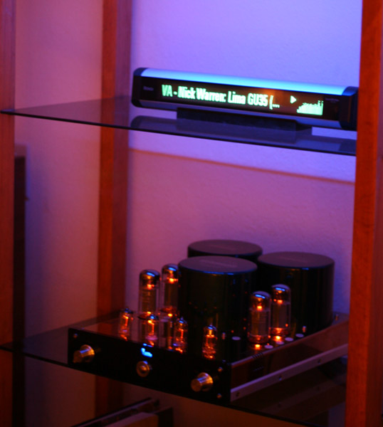

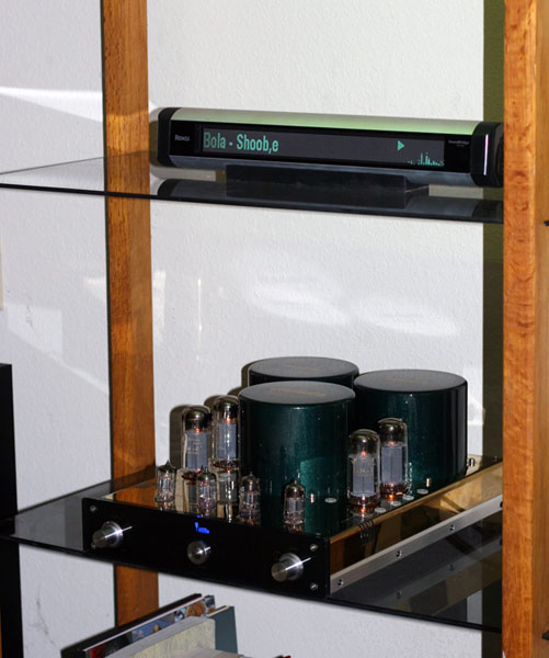

Vacuum tubes and glass shelves do not mix well. Tubes and tube amplifiers are subject to microphonics and glass shelves act as collectors and amplifiers for vibration. Look to the aftermarket for some isolation devices to achieve the best sound from the amplifier. The VibraPods work well for not much money; http://www.audioadvisor.com/products.asp?dept=66
Do some looking and buy what you feel best suits your needs but do get the amplifier off the glass shelf.
