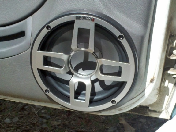

Posted on Thursday, August 16, 2012 - 20:58 GMT I stripped the car down, got the CLD and MLV installed, rear seat is out. I installed my Pioneer HU and MB Quart 6.5 comps. I am in the planning and research phase of my sub install now. I plan to put this solo-x 18 in a sealed box at first, due to the ease and simplicity of box build and the EBP of the sub being 68.54. An EBP of 50-90 can be used for either ported or sealed (under 50=sealed) and I think that it would sound ok. I am not going for any SPL comps, just a daily setup that sounds pretty good. I will be pushing power with an SAE 1200d after I upgrade my electrical appropriately. My questions are: 1) Pros and cons of sealed? Again, I am not going for spl comps. Strictly as SQ as I can get. 2) What is the resonant frequency of this tiny car? And does it even matter if I use a sealed box? 3) The kicker website recommends 6-12 cubes sealed for this beast, so would the size of the Geo's cabin affect the size of the box required to produce the desired frequencies? Pics coming later today... |

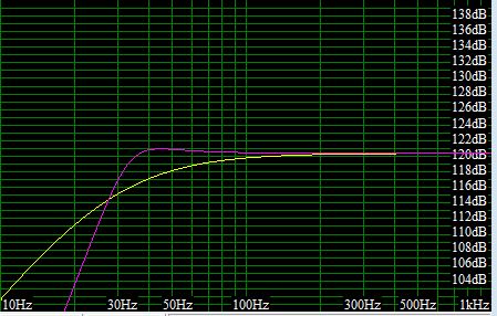

Gold Member Username: Joe1234
Post Number: 1633 Registered: May-09
Posted on Saturday, August 18, 2012 - 06:43 GMT Take a look: The Fi Q 15 2.5 cubes @ 33Hz vs the Solo X sealed @10 cubes. both on 1200 W RMS. As you can see on the same power you would be getting much more bass out of a 3 cubes enclosure. Of course the X will obliterate the Q at 5k ported (on output). |
Post Number: 1634 Registered: May-09
Posted on Saturday, August 18, 2012 - 06:48 GMT And don't worry about the peaking, that happens in small enclosures with Qtc well above 0.7. And yes sealed peaking will make a set of frequencies usually somewhere within the 50-100Hz range to play much louder than the rest resulting in an awful listening experience. |

Posted on Wednesday, August 22, 2012 - 07:54 GMT Thaks for the info guys. Joe, the yellow is the soloX? |

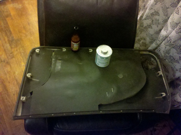

Posted on Wednesday, August 22, 2012 - 07:59 GMT |

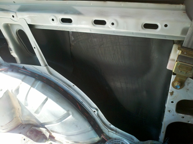

Posted on Wednesday, August 22, 2012 - 08:03 GMT |

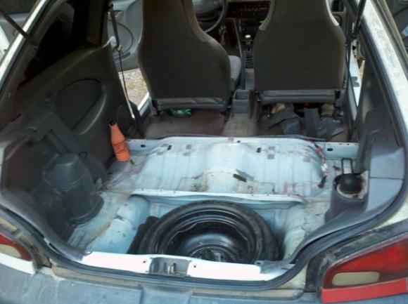

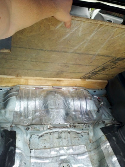

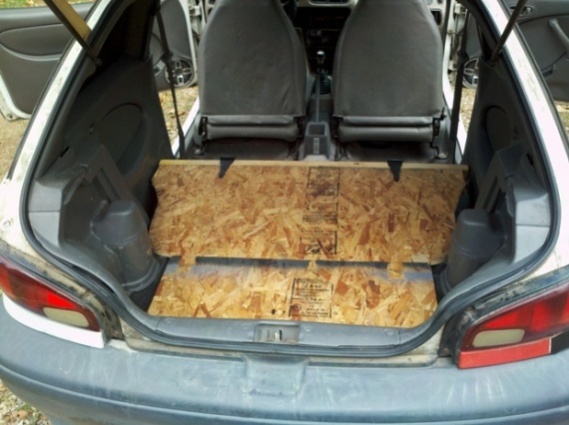

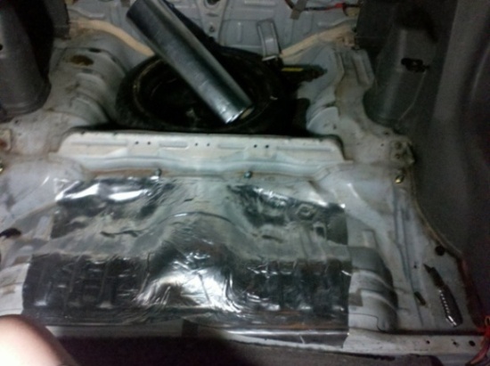

Posted on Wednesday, August 22, 2012 - 08:11 GMT I hate that I didn't take a pic when I had the seats and carpet out. I put CLD and MLV all under the carpet, took the carpet to a pressure washer and industrial cleaner. It turned out real nice. I also put the MLV all on my shock towers and wheel wells and rear tub. I still have a few areas to put the MLV, but the ride is soooo much quieter already. I'm gonna make another floorboard, I don't like how this one turned out. I am also going to put Herculiner on the floorboard. Will post pics of tweets and HU tomoro hopefully |

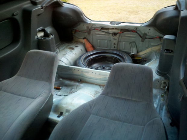

Posted on Wednesday, August 22, 2012 - 08:20 GMT |

Posted on Wednesday, August 22, 2012 - 09:01 GMT Glass, I haven't thought of AP, mainly cuz I know little about it. I do know that this is a hatchback car, and as such, would need the filtered vent going outside of the car somehow. I just can't see this being done. would make for a good box though if I could figure out how... |

Posted on Wednesday, August 22, 2012 - 15:26 GMT nice to see some build pix here on E i'm not familiar with those cars but it kinda looks like the old skool crx which was a good vehicle for spl i seee not much sound deadener being used , i dont know if ur following the "10% is sufficient" guideline or on a tight budget but i'm not a believer of that "rule" at all , personally i like full coverage & a 2nd layer in troubled spots ... |

Posted on Wednesday, August 22, 2012 - 16:28 GMT The yellow is the X sealed, even in the 10 cubes you want will lack bottom end compared to ported performance on equal power. A tight ported box can usually achieve low group delay and can approach sealed performance but with better bottom end. Besides that the X does not belong in a SQ system. |

Posted on Wednesday, August 22, 2012 - 19:43 GMT Rovin, I have read multiple reviews of CLD (the shiny aluminum "sound deadener") (Constrained Layer Dampener) and the general idea is to cover the middle 25% of a car's flat body panels in order to prevent vibration and resonace caused by sound or road vibrations. I feel like this is enough product to do the job, and any more would be a waste. I used off-brand 70-mil butyl rubber dampener wih 8-mil constraining layer. The CLD does very little to block sound. I then covered every sq" that I could with Mass Loaded Vinyl. This is true sound deadener and blocks road noise from the cabin, and blocks music noise from the fuzz. The mlv is 1/8" thick and weighs 1lb per sq". The black under the CLD is RUSTOLEUM spray-on rubber sound deadener. Prolly just a waste of money. Then the MLV on top of the CLD. Except on the door panels, I had to mount the MLV to the interior panel. I used vinyl cement as glue (HH-66). This stuff is HARD CORE! I am going to get some more just to have some on hand. sticks anything to anything! and I did most of this work in 100+ degrees weather. |

Posted on Wednesday, August 22, 2012 - 19:55 GMT The way to do an AP box in a hatch is to build a dual chambered box, with the large chamber containing the sub, firing into the forward, smaller chamber that holds the AP membrane which then fires into the cabin through that membrane. That's just one way to do it, though.. This way is an alternative to having the exterior port, with the membrane affixed directly to the face of the driver. Anyway ywah I think I'd sell that Solo X and look for a more SQ oriented driver.. Something with a round cone, a much better BL curve, and a long, highly-linear excursion. The Fi Q, Alpine type X, and RE XXX are examples of this. |

Posted on Wednesday, August 22, 2012 - 20:33 GMT Joe, I notice that the X has more output from ~10-28hz. Now I realize that 10hz is most likely imperceptible, but with almost 290 sq" of cone area, don't you think that such low-lows could be usable? And getting close to 30 hz is most certainly usable low-low frequency is it not?? And with a flat curve like it has, it would have smooth, predictable output characteristics and not be peeky. Although it does suffer on output in the most-used bass frequencies. Joe, could you model the X sealed in 10 cubes vs. the X ported in 10 cubes @ 35 hz? Both 1200 wrms. That would be a cool matchup. |

Posted on Friday, August 24, 2012 - 21:17 GMT No. 10Hz in your case is absolutely useless. If you're using a ported enclosure, you're going to need a brick wall high pass filter set at or just below the port's tuned frequency anyway, so you won't be producing ANYTHING below that point. Without that filter in place, the driver becomes very difficult to control, and will unload. At that point you'll be glad you have that Solo X, since it has a replaceable voice coil. You'll need it. If you're thinking of a sealed box, then 10Hz still won't really matter, because a ported enclosure will reach lower frequencies than sealed, since a sealed box has a higher natural roll off. The only way to really foce a sealed sub to play lower is to feed it absurd amounts of power. If you're looking at driver response, remember to take into consideration the BL curve of the driver, and the enclosure both, as well as cabin gain, and box impedance rise. If you're after SQ, stop worrying about loss of output between box orders and designs.. any box with adequate power and a quality sub will get more than loud enough for SQ purposes, and for daily driving. The only time output really matters is for SPL competitions on a meter. |
