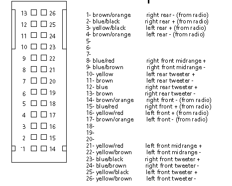

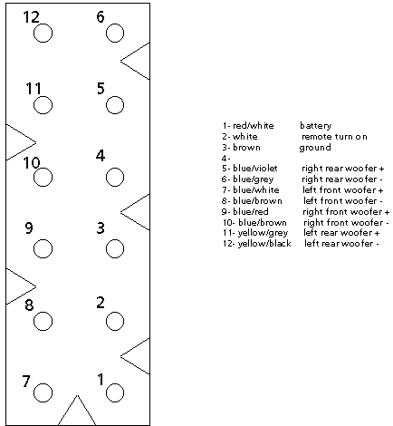

Ok johnny got some infos for you:
You are looking at the connectors on your amp (harman/kardon - which is supposed to be on one side of the trunk) you have a number of inputs that are marked as "(from radio)" and a number of outputs, but as you can see thet are all either for mid or for tweeter (or woofer on the second connector), none of the outputs are full range. Therefore it seems that you are not going to be able to connect full range speakers from it's outputs so you are left with a few options:
1) exchange your full range speakers for "compatible" separate component speakers.

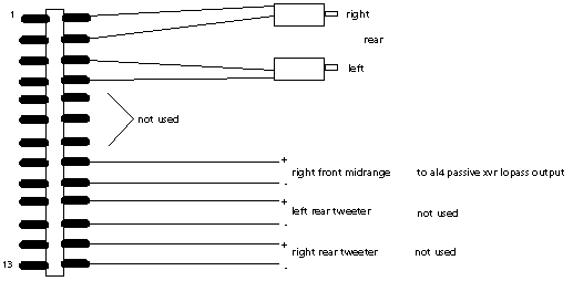

2) get the full range signals from the HU at the amp's first connector and apply that signal to an aftermarket amplifier and then to your new speakers. this is supposed to be done like this for the rear speakers as follows:
As you can see it is not an easy job and I don't have any information to make suggestions, specifically:
1) I don't have the crossover frequencies the amplifier uses to suggest proper components.
2) I don't have the voltage levels that the HU provides to the amp although I don't think that would be a problem.
