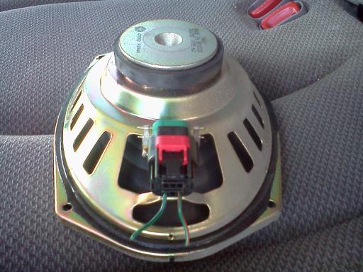

I have a 2002 Dodge Caravan with a Stock Head-Unit. The car has 6 speakers, 4 of which are installed.
two Factory 6x9 Front Door
two Factory 6x9 Rear Pannel
two Empty spaces for 6 1/2' in Front Dash
I installed 6 1/2' Alpine Type S in Front Dash
& Alpine 6x9 Type E in Rear Panel.

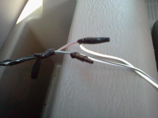

I removed and cut the original speakers from the harness.
Then I spliced the new Speaker harness/wire onto the Vans Speaker cable.
Then used Electrical tape to keep wires stable.
I did this same process to the 6 1/2' speakers in the front dash.

Do you think my method of splicing the wires together with just the electrical tape will provide the same sound quality if soldered?

You should definitely solder if you can just to make sure that in the long term the connection stay solid.
