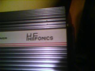

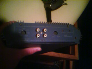

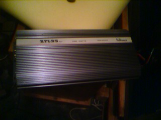

i have an old hifonics amp (ATLAS VII) that will do 600 watts @ 2 ohm (rated) but the gain only goes up to 3.8 volts but my HU *premeier 860, is rated at 6.5 volt preamps, so can i still run this amp?
heres pics
