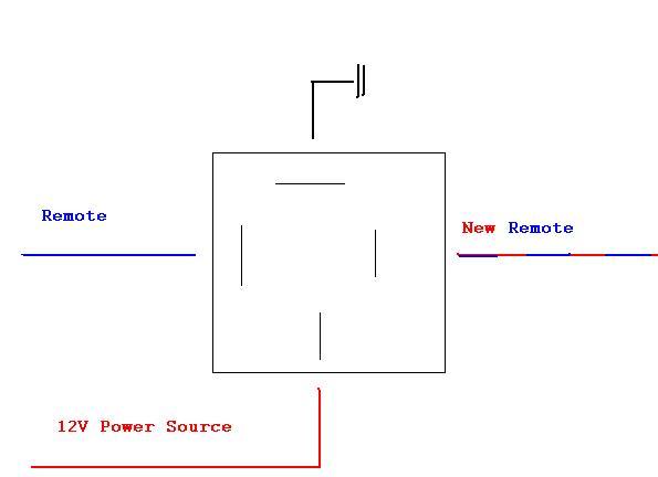

A bosch relay goes something like this...
Should double check and find an exact diagram of course if you're going to wire it like this. Just for demonstration purposes and all, heh heh..
What this will do, is replace your remote wire, with power from a 12v source, so you dont need to worry about damaging your head unit. Basically the remote switch, is now just used to activate the relay. When the relay is activated, it connects a path (think of flipping a toggle switch) that allows the current to flow to all the accessories etc where you'd normally have the remote wire. Bosch relays cost around $2 at any car parts store.
In your case, if you dont want to wire it to your head unit, you can yes, use the accessory fuse.. They sell small adapters that allow for wires to be attached, then plugged into the normal fuse location, that you could use for this.
Just run the accessory line back to the relay, then have the relays power-out line, running to your inverter. What this will do, is let you leave it on all of the time your car is turned on, (could put in a switch if you wanted to be able to turn it off) and if you forgot to flip the switch off, turning your car off breaks the relays connection anyways, so you would not need to worry about your battery being drained.
